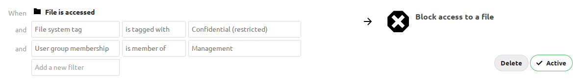

Denying access to folders
The easiest way to block access to a folder, is to use a collaborative tag. As mentioned in the Available rules section below, either the file itself or one of the parents needs to have the given tag assigned.
So you just need to assign the tag to the folder or file, and then block the tag with a rule group. The check is independent of the user’s permissions for the tag. Therefore restricted and invisible tags are recommended, otherwise a user could remove and reassign the tag.
This example blocks access to any folder with the tag Confidential.
Deny access based on collaborative tag

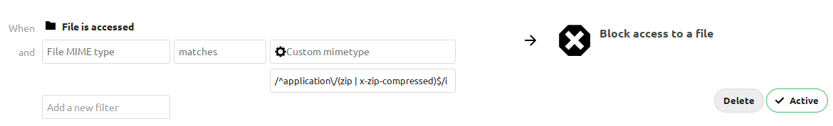

Prevent uploading of specific files
It’s possible to prevent specific files from being uploaded to Nextcloud. You simply need to define a rule based on the mimetype and our powerful access control engine will block any attempt to upload the file. The safest way to define the rule is to use a regular expression, as it will help you cover all the known media types used for the type of file you’re trying to block.
The following example prevents zip files from being uploaded by using the regular expression: /^application\/(zip|x-zip-compressed)$/i
Prevent upload based on mimetype
