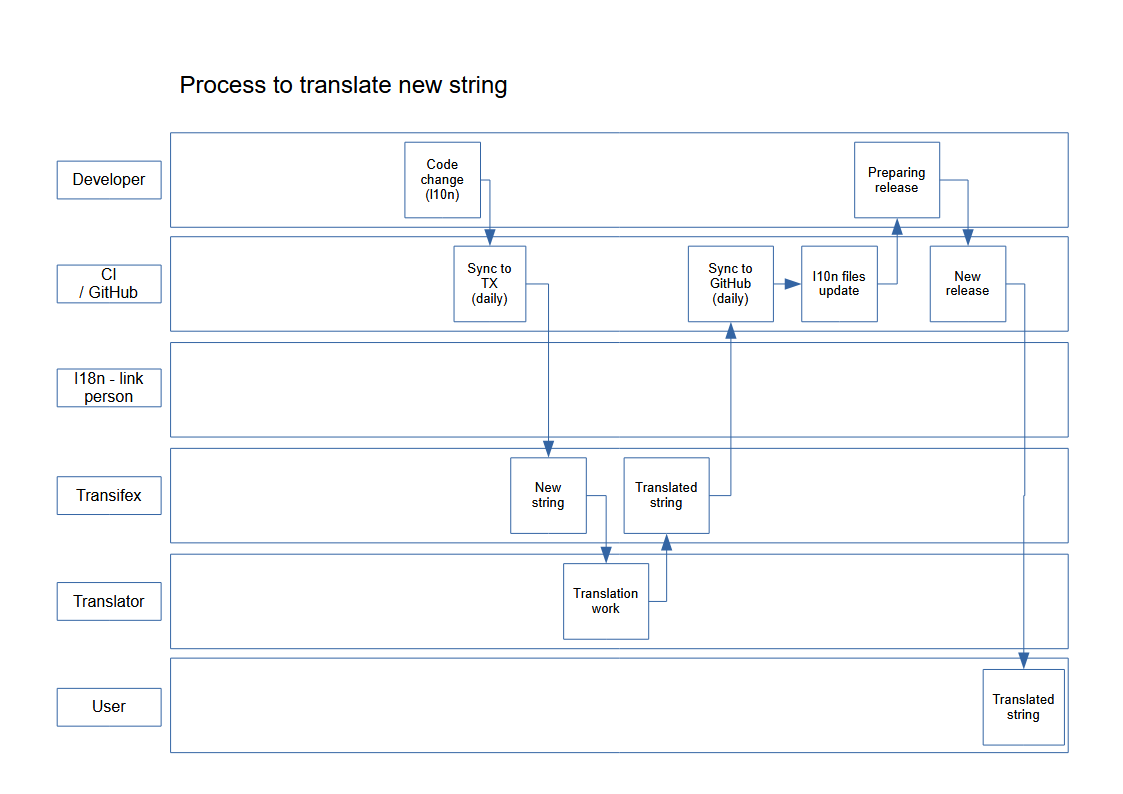

  1. Process to translate new string

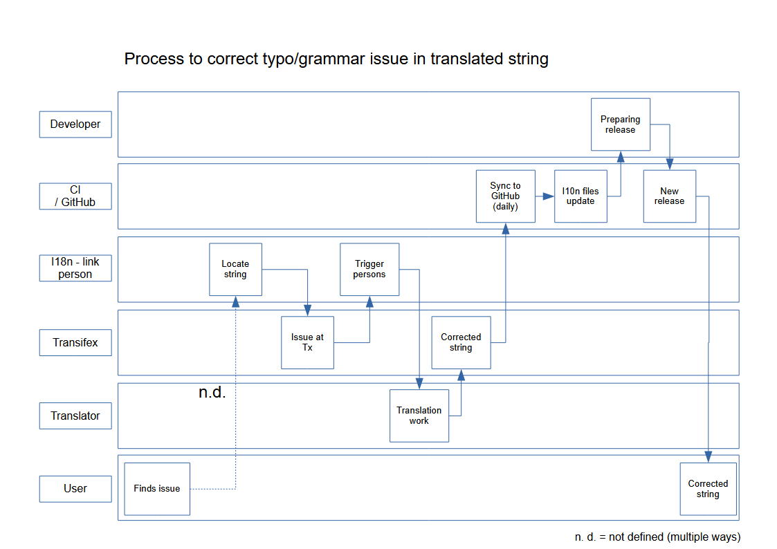

  1. Process to correct typo/grammar issue in translated string

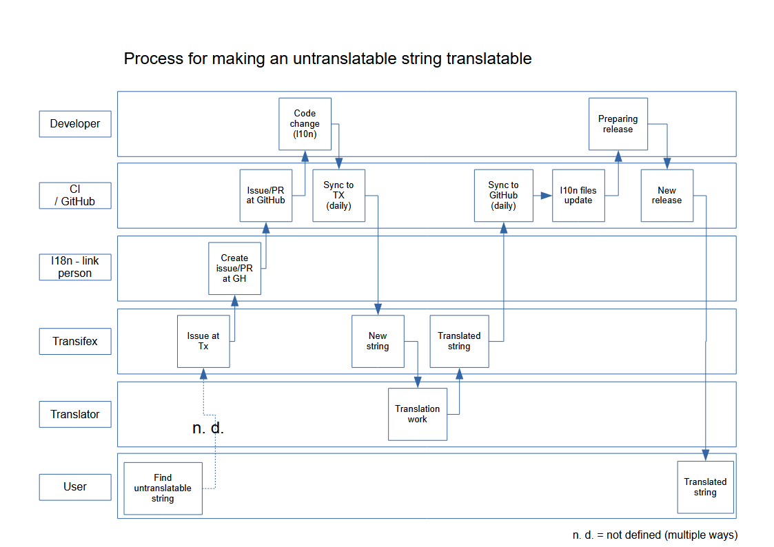

  1. Process for making an untranslatable string translatable

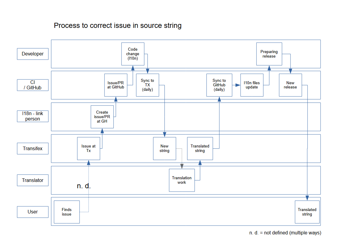

  1. Process to correct issue in source string
