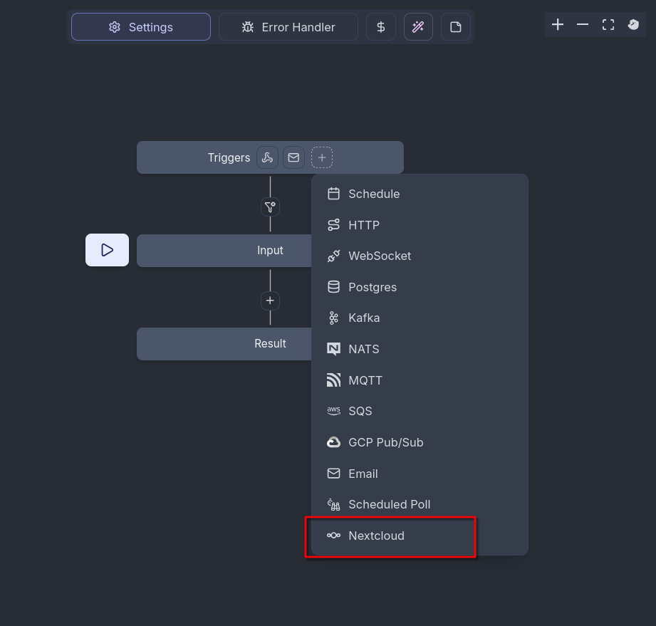

Building a workflow
Each workflow in Windmill is a listener to a Nextcloud Webhook Event. If you are using the ExApp-packaged Windmill, it will automatically register webhooks for the workflows you build using the following mechanism. If you are not using the ExApp-packaged windmill install then you will have to register webhooks for your workflows manually via the webhook_listeners API: see https://docs.nextcloud.com/server/latest/developer_manual/_static/openapi.html#/operations/webhook_listeners-webhooks-index
The magic listener script
The first script (after the “Input” block) in any workflow you build that should listen to a Nextcloud webhook must have “Summary” set to the exact, literal string CORE:LISTEN_TO_EVENT. It must be an empty script with two parameters that you should fill statically: events, which is a list of event IDs to listen to and filters a filter condition that allows more fine grained filtering for which events should be used. The filter condition as well as the available events with their payloads is documented in the webhook_listeners documentation.
You can copy the following Deno script for this:
export async function main(events: string[], filters: object) { }
The webhook data will be made available on the flow “Input” block, not the CORE:LISTEN_TO_EVENT block. Updates to the webhook configuration take effect only when the flow is deployed. Consider disabling any schedule for the flow, since it will be started when a webhook is received.

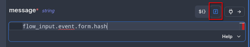

Passing values between blocks
When specifying script inputs you can either fill the parameters with static values or make references to the workflow input and the previous workflow steps.
In order to reference the workflow input, use the flow_input variable.
For example, flow_input.event.form.hash will reference the hash of a form from a nextcloud Forms event.
Each step in a workflow is automatically assigned a letter identifier.
In order to reference results from previous steps in your parameters, use the results variable with the id of the step
to reference as a sub property. For example, use results.e.submission.answers to use the answers of of a form submission
retrieved via the “Get form submission from Nextcloud Forms” script identified with the letter “e”.
