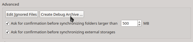

Create Debug Archive
Since the 3.1.0 release we made it easier for users to provide debug information: debug logging is enabled by default with expiration time set to 24 hours and under the “General” settings, you can click on “Create Debug Archive …” to pick the location of where the desktop client will export the logs and the database to a zip file.
Create debug archive

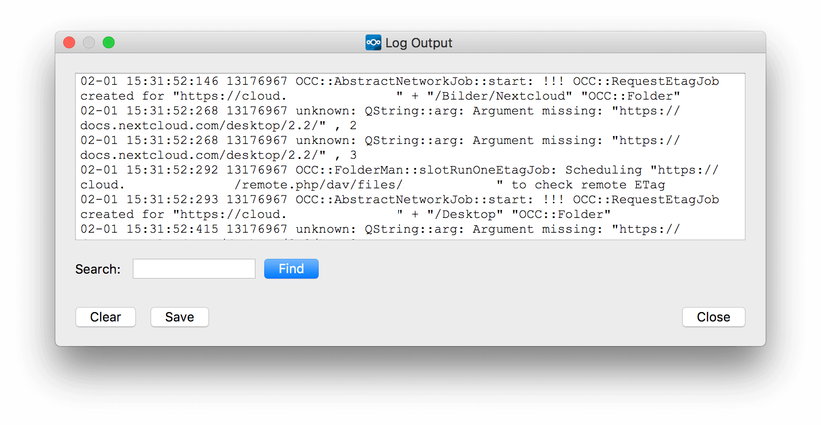

  1. Open the Nextcloud Desktop Client.
  2. Press F12 or Ctrl-L on your keyboard.
The Log Output window opens.
Log output

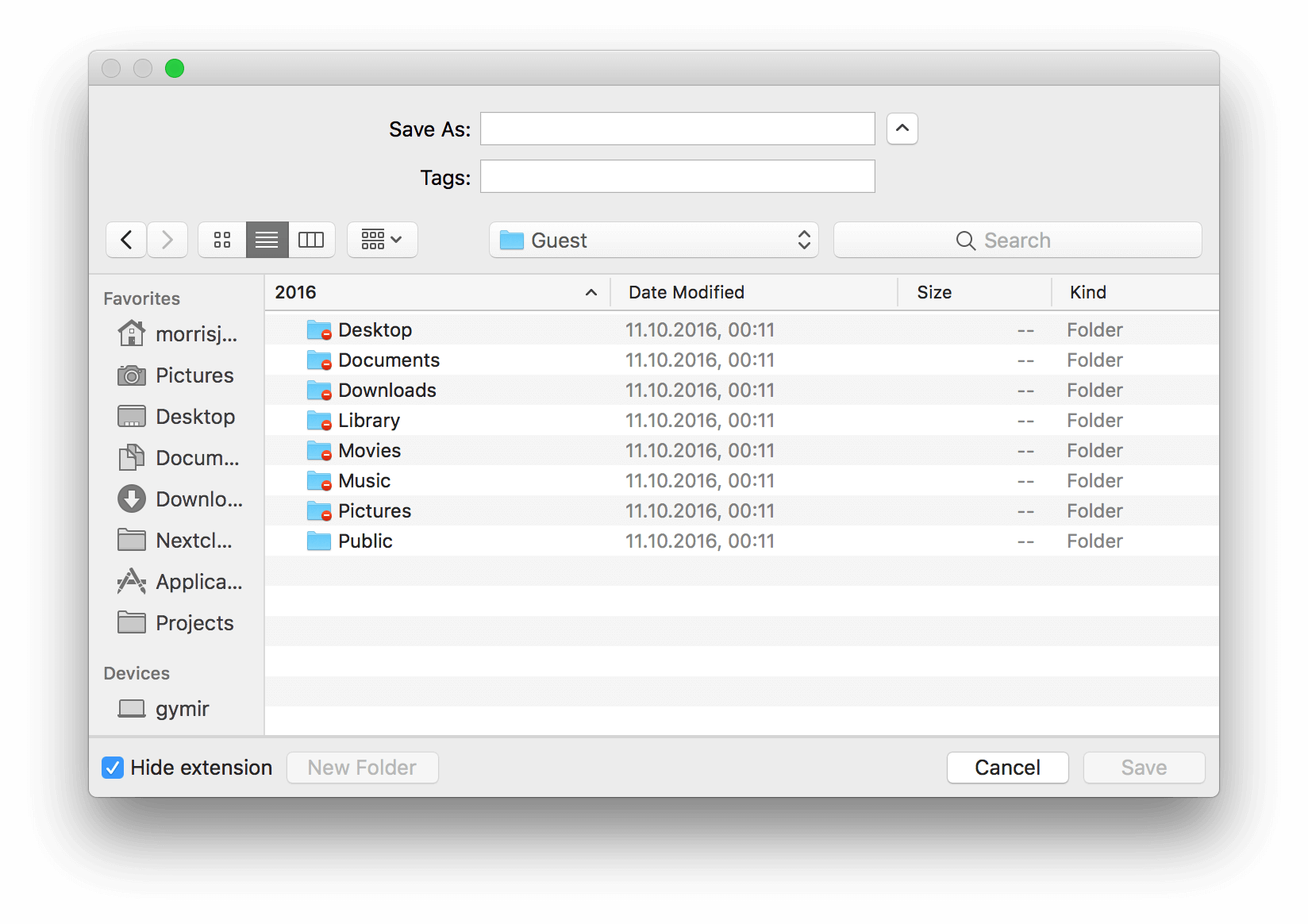

  1. Click the ‘Save’ button.
The Save Log File window opens.
Save logfile
  1. Migrate to a location on your system where you want to save your log file.
  2. Name the log file and click the ‘Save’ button.
The log file is saved in the location specified.
