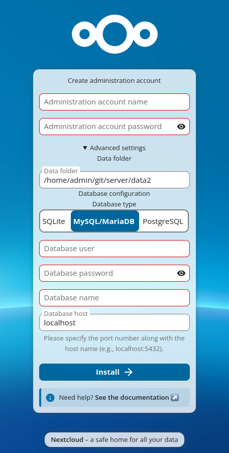

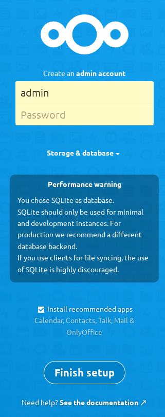

When Nextcloud prerequisites are fulfilled and all Nextcloud files are installed, the last step to completing the installation is running the Installation Wizard. This is just three steps:
  1. Point your Web browser to http://localhost/nextcloud
  2. Enter your desired administration account name and password.
  3. Click Install.
screenshot of the installation wizard
You’re finished and can start using your new Nextcloud server.
Note
The wizard includes a real-time password strength indicator that rates your chosen password from “too weak” to “extremely strong”. For security, choose a password rated at least “strong”.

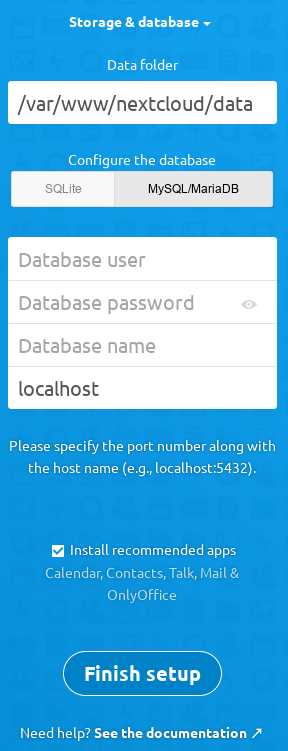

Data directory location
Expand the Storage & database section to expose additional installation configuration options for your Nextcloud data directory and database.
You should locate your Nextcloud data directory outside of your Web root if you are using an HTTP server other than Apache, or you may wish to store your Nextcloud data in a different location for other reasons (e.g. on a storage server). It is best to configure your data directory location at installation, as it is difficult to move after installation. You may put it anywhere; in this example it is located in /opt/nextcloud/. This directory must already exist, and must be owned by your HTTP user.

Database choice
SQLite is the default database for Nextcloud Server. When SQLite is selected, the wizard displays a Performance warning:
SQLite should only be used for minimal and development instances. For production we recommend a different database backend. If you use clients for file syncing, the use of SQLite is highly discouraged.
Supported databases are MySQL, MariaDB, Oracle, and PostgreSQL, and we recommend MySQL/MariaDB. Your database and PHP connectors must be installed before you run the Installation Wizard. When you install Nextcloud from packages all the necessary dependencies will be satisfied (see Installation on Linux for a detailed listing of required and optional PHP modules). If only one database driver is available, the wizard will show a notice and a link to the documentation on how to install additional PHP modules.
When you select a database other than SQLite, the wizard exposes additional fields:
  • Database user: The username to connect to the database server. If this user has sufficient privileges (e.g. the ability to query mysql.user for MySQL, or the CREATEROLE privilege for PostgreSQL), the wizard will attempt to create a dedicated Nextcloud database user with limited privileges (see below). If the user lacks those privileges, the wizard gracefully falls back to using the provided credentials directly.
  • Database password: The password for the database user above.
  • Database name: The name you want for your Nextcloud database. The wizard will create it if it does not already exist and the user has CREATE DATABASE privileges.
  • Database host: The hostname (and optionally port) of your database server, e.g. localhost or db.example.com:3306. The default is localhost. You can also specify a Unix socket path here. The wizard shows a helper hint: “Please specify the port number along with the host name (e.g., localhost:5432).”
  • Database tablespace (Oracle only): Shown only when Oracle is selected.

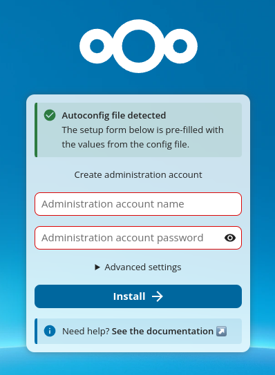

Autoconfig
If an autoconfig file is detected, the wizard displays a success notice: “Autoconfig file detected — The setup form below is pre-filled with the values from the config file.” The Storage & database section is automatically collapsed when the autoconfig provides valid values. For details on autoconfig files, see Automatic setup.

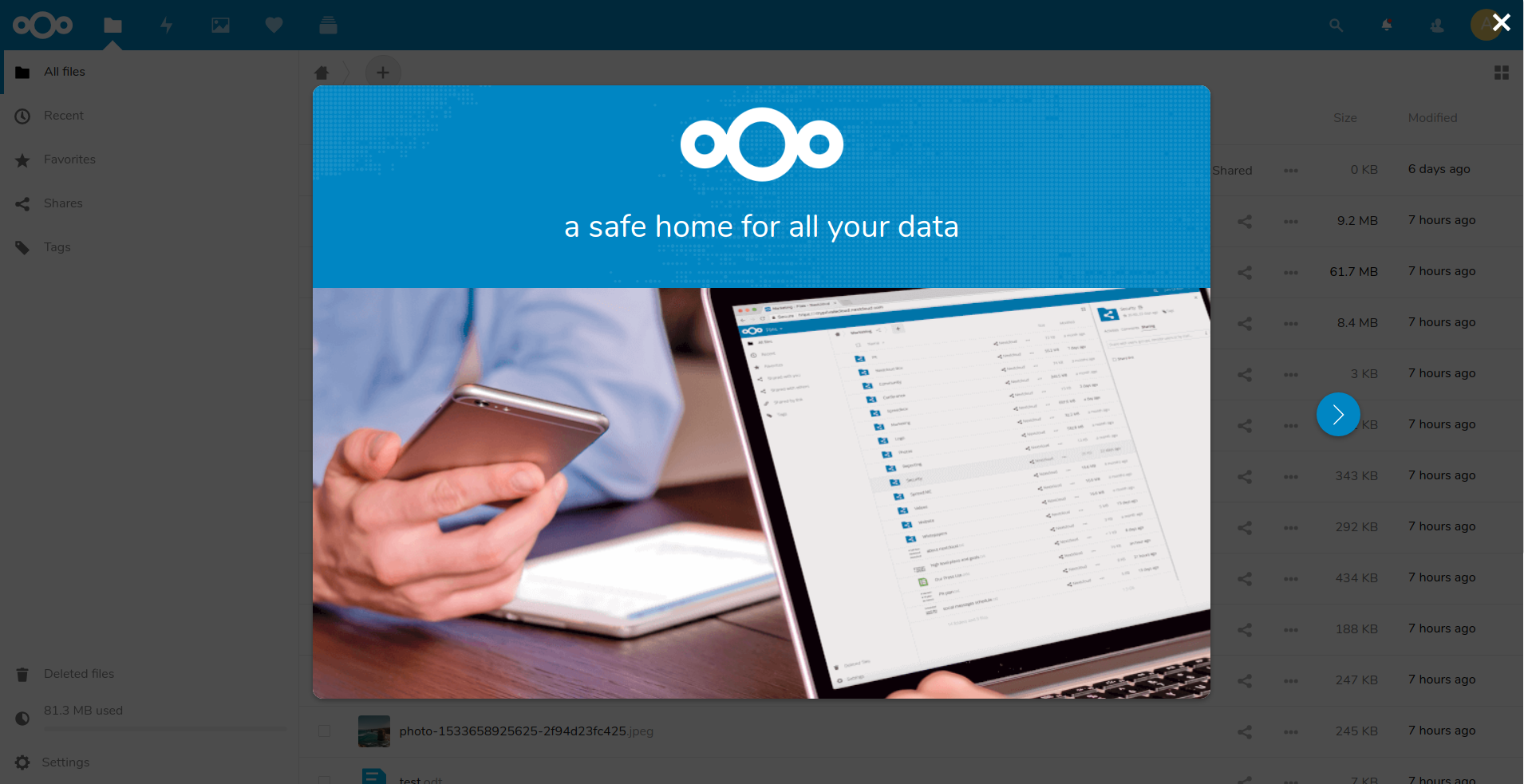

Completing Installation
Click Install, and start using your new Nextcloud server.
Nextcloud welcome screen after a successful installation

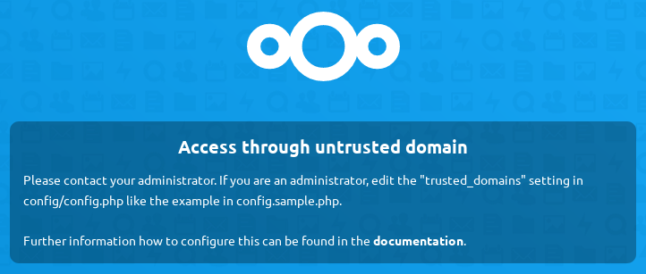

When a user tries a URL that is not whitelisted the following error appears:
Error message when URL is not whitelisted
