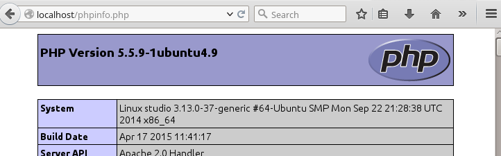

PHP version and information
You will need to know the PHP version and configuration that is in-use on your
Nextcloud server. This will not necessarily be the same version and configuration as
can be reached from the command-line. The simplest way to gather this information is
by using what’s commonly referenced as phpinfo().
The most accurate - and easiest - way to access phpinfo is by checking it from
within Nextcloud itself. Of course, this requires that Nextcloud is functioning
enough that you can log in as an administrator and access the
Administration settings -> System menu. If so, you can enable the exposure of
phpinfo data by toggling it on via occ:
./occ config:app:set --value=yes serverinfo phpinfo
From then on a new button labeled Show phpinfo will be visible in the web interface under Administration settings -> System. Clicking it will expose just about everything you may want to know about your PHP environment.
If accessing the Nextcloud web interface is not an option, you may create a
plain-text file named phpinfo.php and place it in your Web root, for
example /var/www/html/phpinfo.php. (Your Web root may be in a different
location; your Linux distribution documentation will tell you where.) This file
contains just this line:
<?php phpinfo(); ?>
Open this file in a Web browser by pointing your browser to
localhost/phpinfo.php:
Your PHP version is at the top, and the rest of the page contains abundant
system information such as active modules, active .ini files, and much more.
When you are finished reviewing your information you must delete
phpinfo.php, or move it outside of your Web directory, because it is a
security risk to expose such sensitive data.
