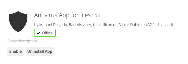

Enabling the antivirus app for files
Place the files_antivirus app into the apps directory of your Nextcloud
server. Then the app shows up on the Nextcloud Apps page where it simply can be
enabled.

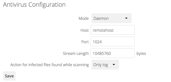

ClamAV runs in one of three modes:
Daemon (Socket): ClamAV is running on the same server as Nextcloud. The ClamAV daemon,
clamd, runs in the background. When there is no activityclamdplaces a minimal load on your system. If your users upload large volumes of files you will see high CPU usage.Daemon: ClamAV is running on a different server. This is a good option for Nextcloud servers with high volumes of file uploads.

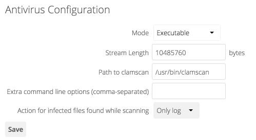

Executable: ClamAV is running on the same server as Nextcloud, and the
clamscancommand is started and then stopped with each file upload.clamscanis slow and not always reliable for on-demand usage; it is better to use one of the daemon modes.

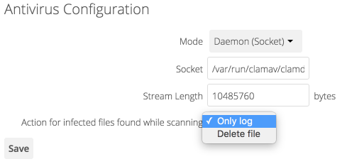

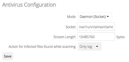

- Daemon (Socket)
Nextcloud should detect your
clamdsocket and fill in theSocketfield. This is theLocalSocketoption inclamd.conf. You can runnetstatto verify:netstat -a|grep clam unix 2 [ ACC ] STREAM LISTENING 15857 /var/run/clamav/clamd.ctl
The
Stream Lengthvalue sets the number of bytes read in one pass. 10485760 bytes, or ten megabytes, is the default. This value should be no larger than the PHPmemory_limitsettings, or physical memory ifmemory_limitis set to -1 (no limit).Action for infected files found while scanninggives you the choice of logging any alerts without deleting the files, or immediately deleting infected files.- Daemon
For the Daemon option you need the hostname or IP address of the remote server running ClamAV, and the server’s port number.
- Executable
The Executable option requires the path to
clamscan, which is the interactive ClamAV scanning command. Nextcloud should find it automatically.

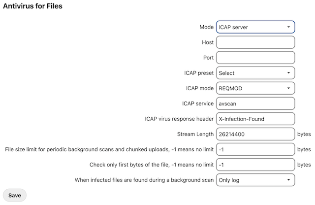

Configuring ICAP on Nextcloud
Nextcloud offers the integration of antivirus protection based on the ICAP protocol. The settings are outlined here. Additional documentation is work in progress.
