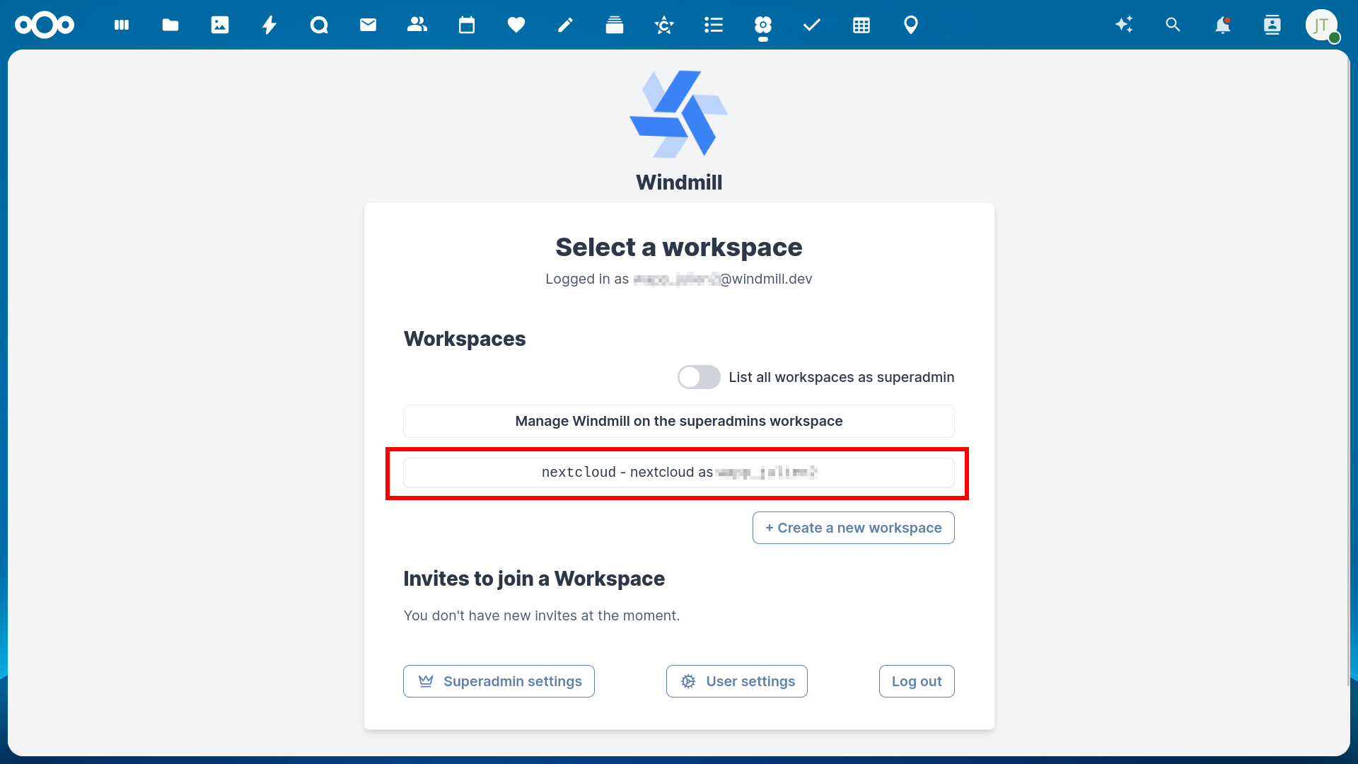

Selecting the right Workspace
With Windmill installed as an ExApp, the first time one visits Windmill’s web interface, make sure to select the right workspace on the first run: Only the pre-existing “nextcloud” workspace is hooked up to nextcloud’s internal event system, all other workspaces will need manual webhook setups for each workflow. If the wrong workspace is selected on the first run, it is always possible to switch workspace later in the left sidebar.
Screenshot of the workspace selector screen when opening Windmill for the first time

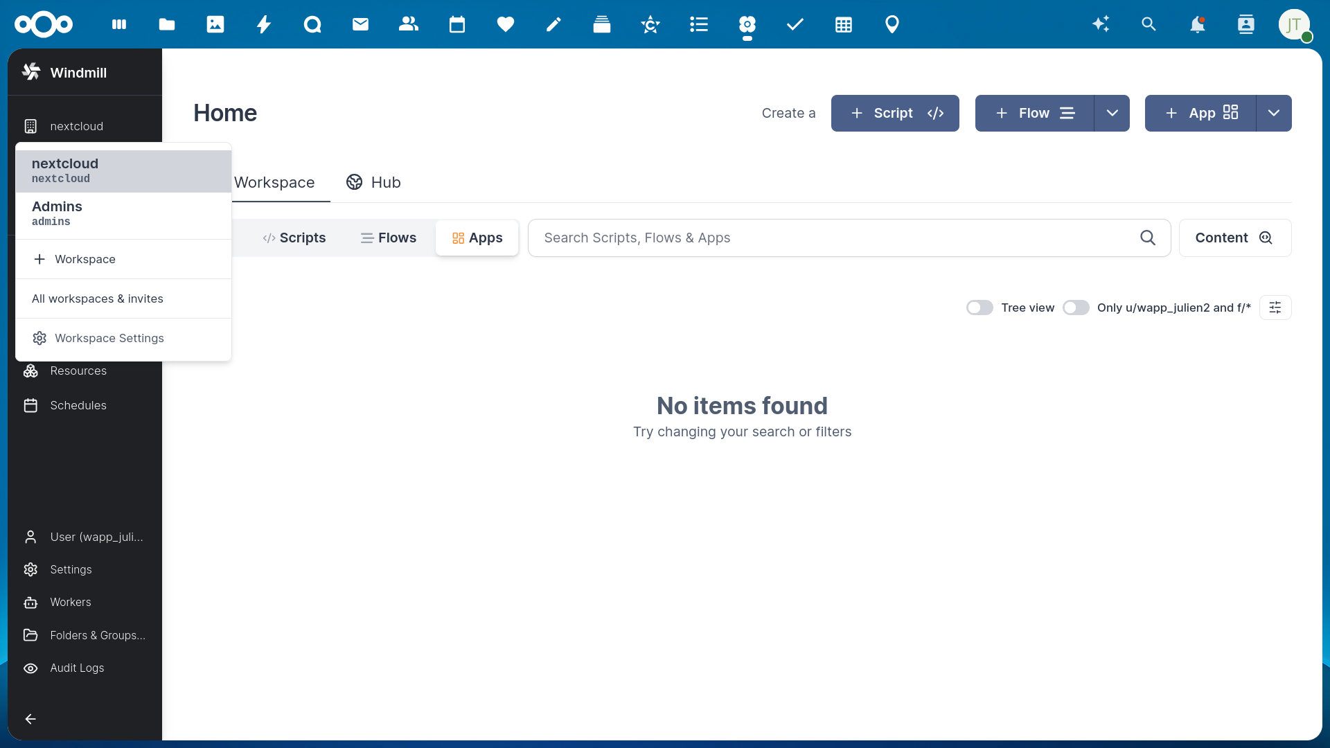

If you wish to change to a different workspace at a later time, you can do so via the workspace selector in the left sidebar of Windmill.
Screenshot of the workspace selector when a workspace is already opened

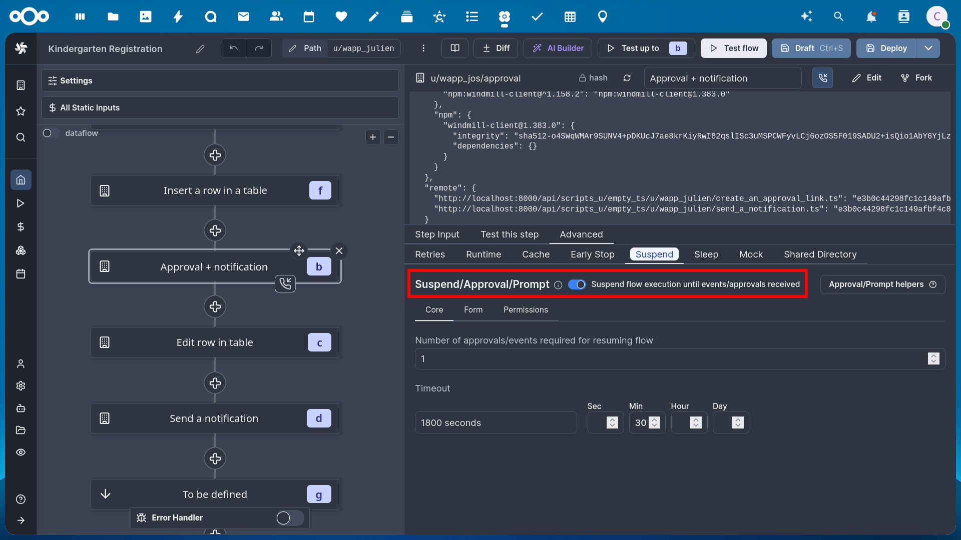

Approval/Suspend steps
Windmill allows using so-called approval steps, which are essentially asynchronous scripts that wait for the call to an additional webhook URL. The most prominent use case for this are approval workflows where you get automated input from somewhere which needs to be approved by a human. Once the human approves or disapproves by triggering the webhook URL the workflow will resume.
In order to turn a newly added step into an approval step, the workflow edit screen, select the script and in the bottom right pan, go in the “Advanced” tab, “Suspend” sub tab and check “Suspend/Approval/Prompt”.
Screenshot of the workspace edit screen to turn a normal step into an Approval step
