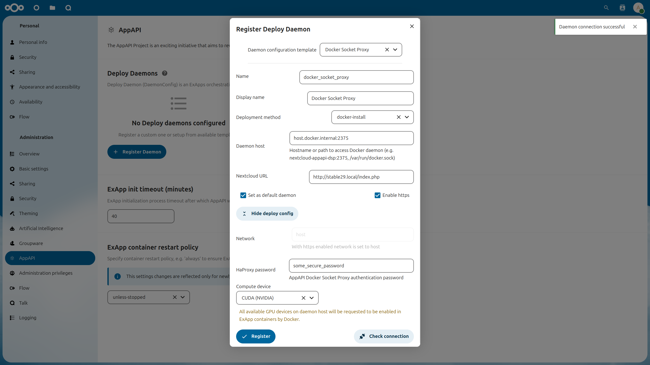

Docker Socket Proxy
  1. Setup a Docker container called docker-socket-proxy that proxies access to Docker for your Nextcloud instance.
  2. Go to the AppAPI admin settings.
  3. Click on the “Register Daemon” button.
  4. Fill in the required fields:
    • Name: unique name of the Deploy daemon
    • Display name: the name that will be displayed in the UI
    • Deployment method: by default, you will need to choose docker_install (manual_install is for development or custom use case of manual ExApp installation)
    • Daemon Host: hostname/IP address + port of the Deploy daemon
    • Nextcloud URL: autofilled with current domain, you might need to change the protocol to http/https depending on your setup
    • Set as default daemon: check if you want set new Deploy daemon as default
    • Enable https: check if your Deploy daemon (Docker Socket Proxy) is configured with TLS
    • Deploy Config:
      • Network: Docker network name, depends on your networking setup, enforces to “host” if “Enable https” is checked
      • HaProxy password: password for Docker Socket Proxy, if it is configured with TLS
      • Compute Device: CPU, CUDA or ROCm, depending on your hardware config on Deploy daemon host machine
      • Add additional option (see Additional options): setup additional KEY + VALUE deploy config options
  5. Click “Check connection” to verify that the configuration is correct.
  6. Click “Register” to save the Deploy Daemon configuration.
Note
For remote DSP setup, it should expose the ports on the host.
../_images/app_api_3.png
Deployment configuration examples can be found here.

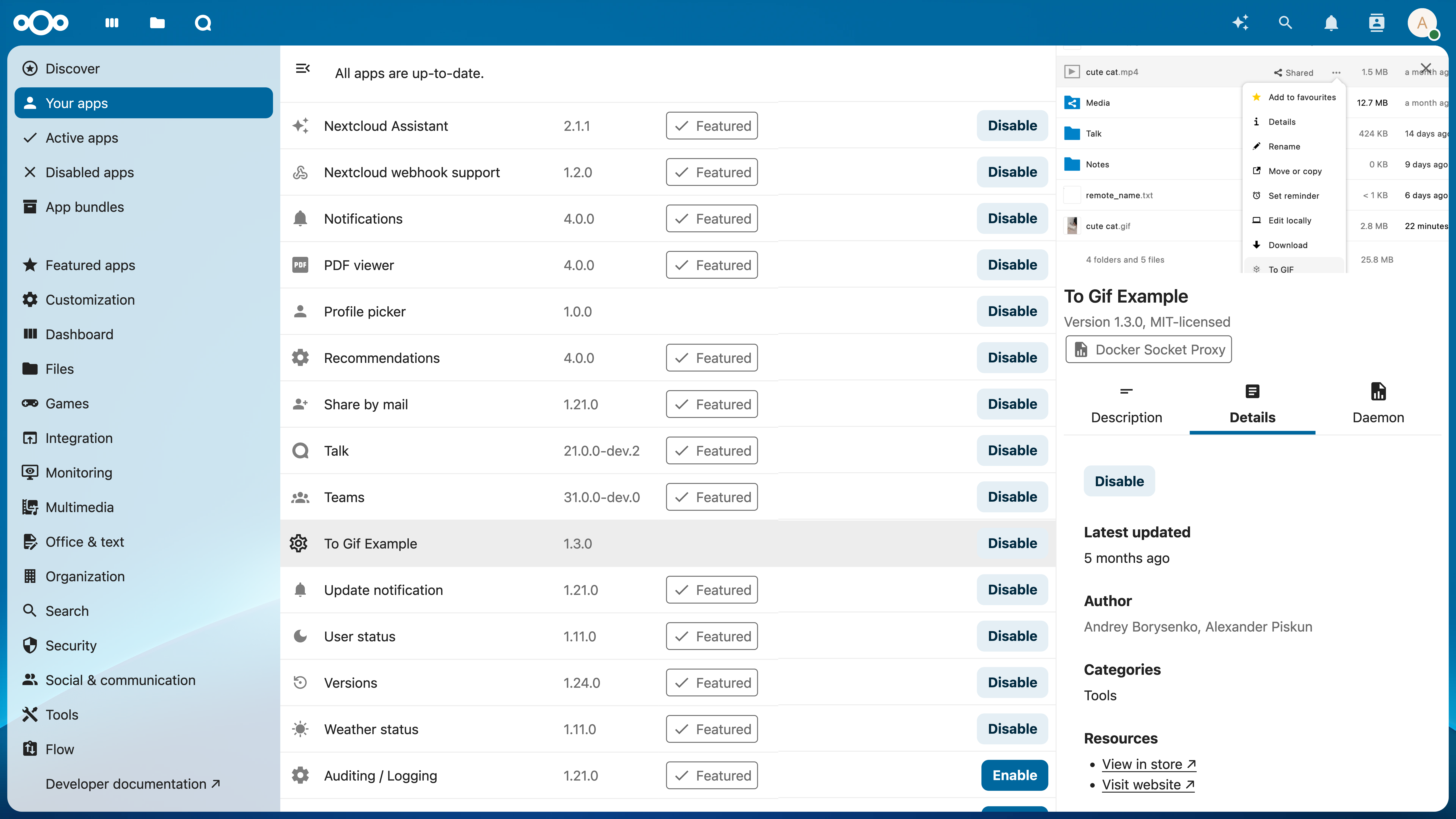

Installing ExApps
You can now install ExApps from the Nextcloud App Store by clicking “Install” on the respective app in the Apps page. If successful, the ExApp will be displayed under the “Your apps” list.
../_images/exapp_list_example.png
