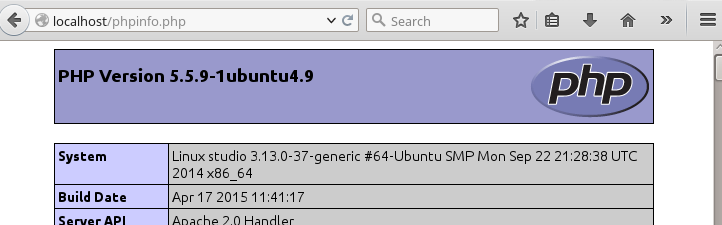

If accessing the Nextcloud web interface is not an option, you may create a
plain-text file named phpinfo.php and place it in your Web root, for
example /var/www/html/phpinfo.php. (Your Web root may be in a different
location; your Linux distribution documentation will tell you where.) This file
contains just this line:
<?php phpinfo(); ?>
Open this file in a Web browser by pointing your browser to
localhost/phpinfo.php:
Your PHP version is at the top, and the rest of the page contains abundant
system information such as active modules, active .ini files, and much more.
When you are finished reviewing your information you must delete
phpinfo.php, or move it outside of your Web directory, because it is a
security risk to expose such sensitive data.
