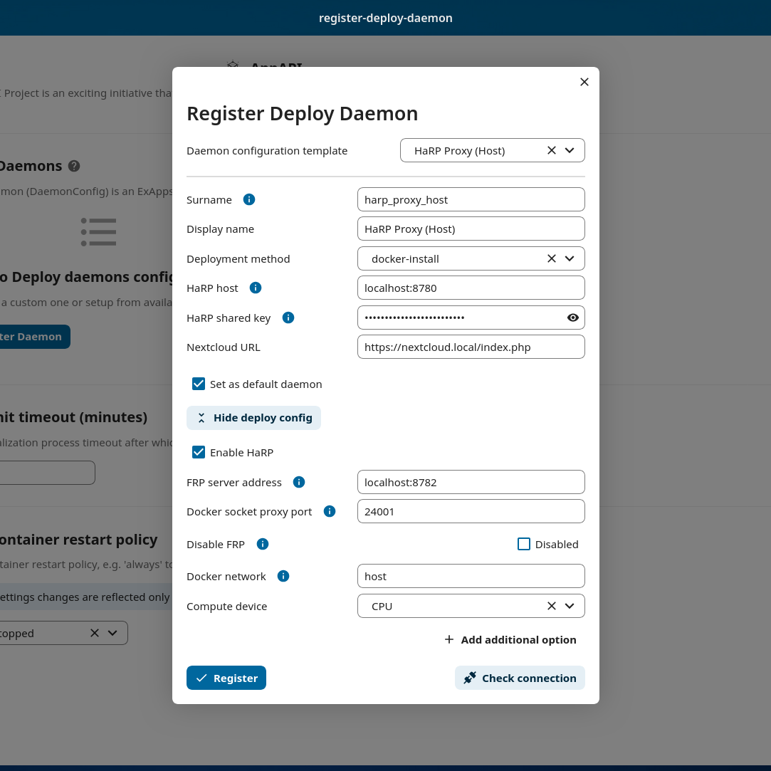

Go to AppAPI admin settings and register a HaRP Proxy (Host) daemon.
../_images/harp_host.png
Finally, test the whole setup with “Test deploy” in the 3-dots menu of the deploy daemon.
