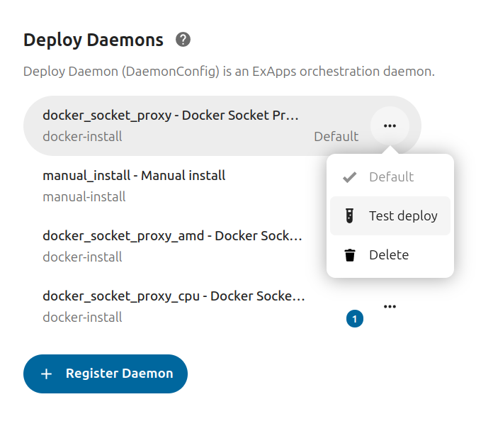

Test Deploy Daemon

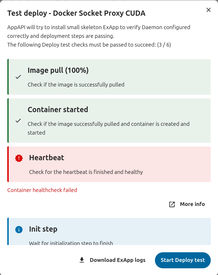

You can test each Daemon configuration deployment from the AppAPI Admin settings.
Status Checks
The Deploy test installs a test-deploy ExApp to verify each step of the deployment process, including a hardware support check - for each compute device, there is a separate Docker image.

Register
The Register step is the first step; it checks if the ExApp is registered in Nextcloud.
Image Pull
The Image Pull step downloads the ExApp Docker image.
Possible errors:
Image not found (e.g. not public, no image found for your hardware architecture)
Image pull failed (e.g., due to network issues)
Image pull timeout
Your Docker Socket Proxy/HaRP is not configured correctly and blocks access to this Docker Engine API
See journalctl -f -u docker.service for more details in systemd based systems.
Container Started
The Container Started step verifies that the ExApp container is created and started successfully.
Possible errors:
- Container failed to start with GPU support (may be missing or misconfigured)
For NVIDIA, refer to the NVIDIA Docker configuration docs.
For AMD, refer to the ROCm Docker configuration docs.
The ExApp issue during startup (e.g. not enough memory). The app would show repeated starting attempts in the logs.
See docker logs nc_app_<app_id> for more details.
Heartbeat
The Heartbeat step checks if the container’s health check is finished and the container is healthy. The ExApp might have additional pre-configuration logic during this step.
Possible errors:
ExApp failed to start a web server, e.g., if the port is already in use (this should be visible in the container logs)
ExApp heartbeat_count keeps increasing, this may indicate that the ExApp couldn’t start properly
- Nextcloud can not reach the ExApp container, e.g.,
due to a network issue or a firewall (this should be visible in the server logs or the firewall logs)
due to a “http” protocol deploy daemon. In this case, the ExApp’s container listens on localhost (127.0.0.1 or ::1) which might not be reachable from the Nextcloud server and you might want to listen on a different IP address. See
OVERRIDE_APP_HOSTin Additional options in the Deploy Daemon form. This issue can be identified using this command:lsof -i -P -n | grep LISTEN
For HaRP, the main Nextcloud proxy might not be configured to redirect requests to the HaRP container correctly. See the Configuring Your Reverse Proxy section in the HaRP readme.
Init
The Init step checks if the ExApp is initialized and ready to use. During the init step, the ExApp may perform downloads of extra stuff required for it.
Possible errors:
Initialization failed (e.g., due to network issues or timeout)
ExApp not being able to reach the Nextcloud server (e.g., due to a network issue or a firewall)
Enabled
The Enabled step checks if the ExApp is enabled and ready to use. During this step, the ExApp registers all the required and available APIs of the Nextcloud AppFramework.
Possible errors:
ExApp did not respond to the enable request
ExApp failed to enable due to a failure in registering AppAPI Nextcloud AppFramework APIs (this should be visible both in the container logs and in the Nextcloud logs if there are any errors)
