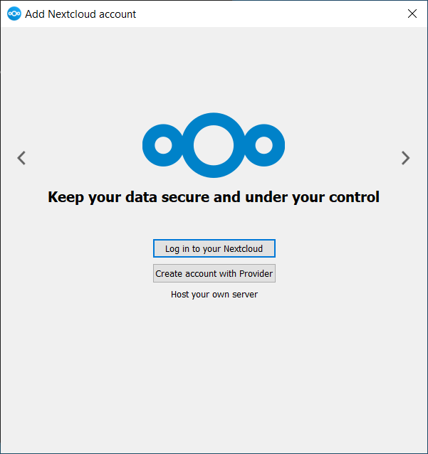

form for choosing between login and registering
If you already have an account on a Nextcloud instance, click Login to your Nextcloud. If you do not yet have a Nextcloud instance or an account, you may need to create one first. Alternatively, you might want to register an account with a provider. Press Create account with Provider in that case.

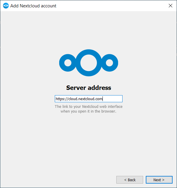

form for entering Nextcloud server URL
Enter the URL for your Nextcloud instance. The URL is the same URL that you type into your browser when you try to access your Nextcloud instance.

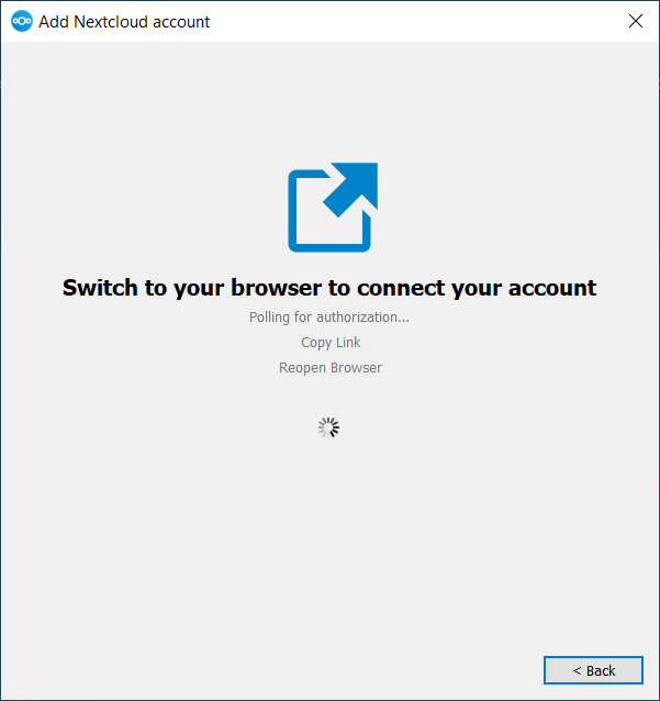

form waiting for authorization
Now your web browser should open and prompt you to log in to your Nextcloud instance. Enter your username and password in your web browser and click Grant access when prompted. After you do that, go back to the wizard.
Nota
You might not need to enter your username and password if you are already logged in to your web browser.

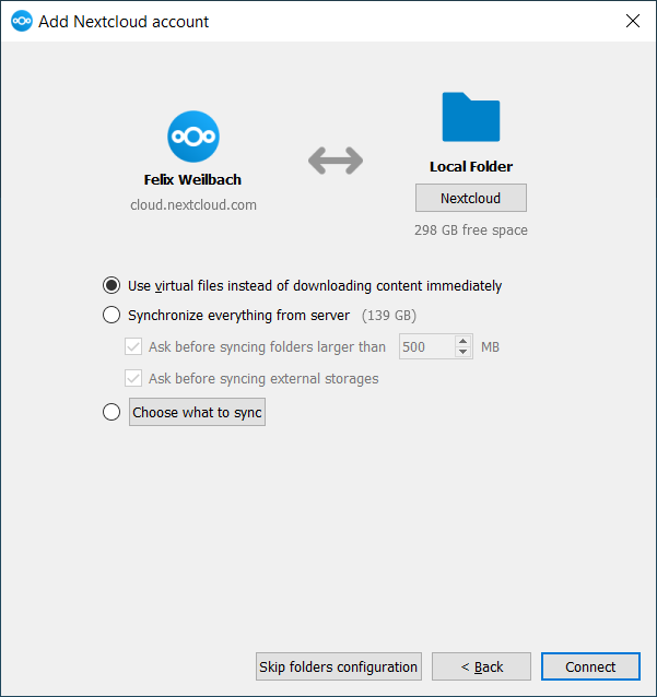

Select which remote folders to sync, and which local folder to store them in.
On the local folder options screen, you may sync all of your files on the Nextcloud server, or select individual folders. The default local sync folder is Nextcloud, in your home directory. You may change this as well.
When you have completed selecting your sync folders, click the Connect button. The client will attempt to connect to your Nextcloud server. If it is successful, the wizard will close itself. You can then observe the sync activity and open the main dialog by clicking on the tray icon.
